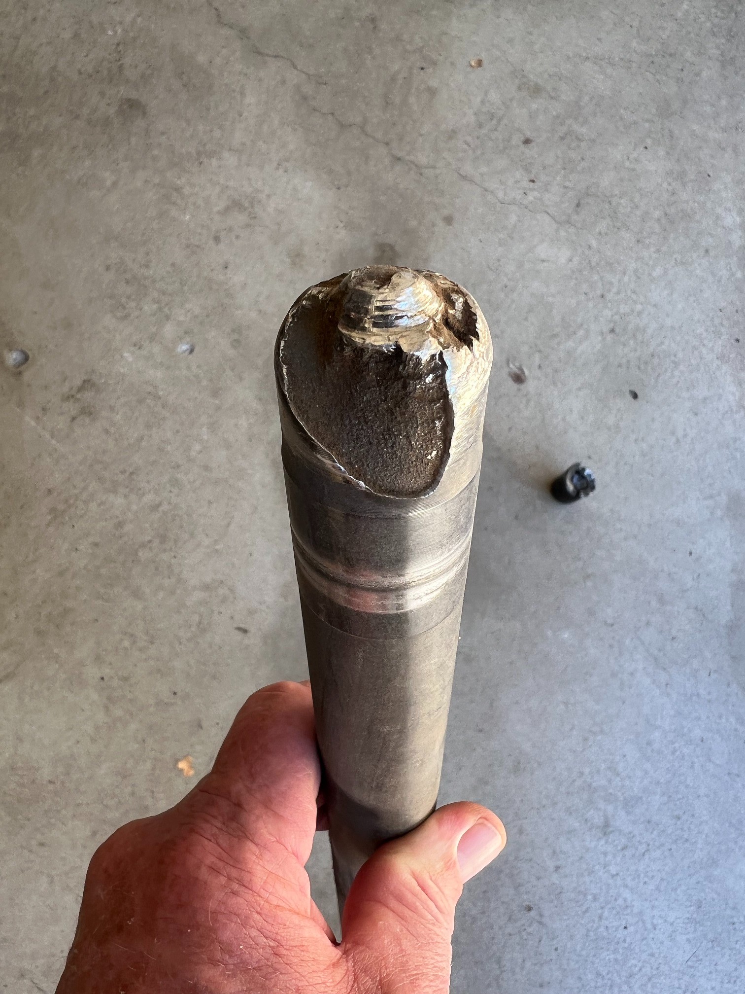

Here is an update on my Jeep. I took it to WFO today. Danny, who I have dealt with for many years, is no longer there and apparently opened his own shop. They now have a suspension division and a gear and axle division which is just across the parking lot. I went in and they sent me over to the gear and axle division. I was told that a new G2 front Dana 44 would be about six months out (I have a Dana 30). I asked about the warranty on my 12 year old broken G2 front, inner passenger side axle shaft which I purchased from WFO and had them install years 12 ago. He recommend that I call G2 and inquire about getting a warranty replacement. According to their website it appears there is a 10 year warranty on it and it is 12 years old.
When I called G2 they asked me to email them pictures of the broken axle, a copy of my receipt and my shipping address. They got back to me quickly and asked how it broke and which side it was. I'm hopeful that they will send me a replacement. If they do replace it then the immediate plan, given how long it may take to get a new Dana 44, is to fix my Dana 30. If I do, I'm hoping that I can get some help from some club members since I'm not much of a mechanic and this is over my head. If they don't send me a free replacement then I need to purchase a new G2 replacement axle for a little under $200 or I could just put the stock shaft back in for now. In either case, I will eventually upgrade to a Dana 44.
I'm currently trying to determine what other parts I will need to fix it if I go that route. I know I need to fix or replace my front ARB seal housing because the copper air line broke off and was just sitting in the bottom of the diff. I need a new axle seal, diff cover bolts, U-joints and I'm sure more. Hopefully I will hear back from G2 tomorrow and then figure out which way to go. Suggestions are welcome!
IMG_1346.JPGImage EnlargerIMG_1348.JPGImage Enlarger

Thanks Robert. The good news: G2 will replace by broken axle under warranty. The bad news: 4 to 6 weeks for delivery! I ordered a new G2 axle which should arrive on Friday. I hope I can just return the warrantied one in place of the new one after I receive it. If not, I will just keep the extra one for a spare.
I have ordered or will pick up the rest of the parts I need to fix my Dana 30. Once I get everything together it would be great if you could give me a hand putting it back together. Do you remember or know where the spacers go? I think they all came off the driver's side but I'm not sure. I have ordered new axle seals and will replace both of them as I know the passenger side was damaged. I'm hoping to get everything fixed well before the Slick Rock/Deer Valley run so I can test it a few times before I take it out on those trails.
I solved the mystery as to why the front axle housing breather was venting when the rear air locker was turned on. It turns out that the wires from the switches to the solenoids were reversed. I'm not sure if WFO did this or if I put them back wrong when I installed my ARB twin compressor. I remember marking them so that I would be sure put them back in the same position when I did the work so I'm not sure how they got reversed. I would like to think that it was my fault since WFO is such a good shop. In either case, it appears my rear locker is working fine now that I have the wires going to the correct solenoids. I will be picking up a new ARB seal housing kit from West Coast Differentials tomorrow. Apparently it is not uncommon for the copper air line to get caught up in the gears and shear off thereby disabling the locker. There is an aftermarket kit bracket kit to help prevent this. Looks like this is sold in the UK so I won't be purchasing one but looks like a good concept. .

I can't get the seal housing off. Mine doesn't have clips and should just slide on and off. I called WFO and he said that it probably got too hot and welded the seal housing on. He said I probably need to buy a new locker. If that's the case, then I will need to upgrade to a Dana 44 and won't be wheeling for a while since Dana 44's are like six months out.

The broken end of the shaft was turning inside the locker and appears to have been creating a lot of friction. There is significant evidence of damage inside the locker where the broken shaft was making contract with it. If you look at the picture of the broken end of the axle shaft, it appears polished from friction so I suspect there was sufficient heat buildup to damage it. Time for a Dana 44. I will start a new thread because I need advice as to how to proceed with the upgrade.
